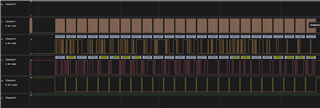

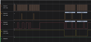

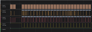

when Entering Limp home mode, the Buck takes the last configured value in Device configuration Registers not the configuration in Limp home mode registers
and when we cleared the channel 2 LMH configurations we found that channel 1 enter Limp home mode with LMH register configurations
and we capture the first case Logic log when writing LMH configuration upon initialization and found that there's some values not written properly like shown in here:
but in the second case's capture log written mostly correct like shown in here:
