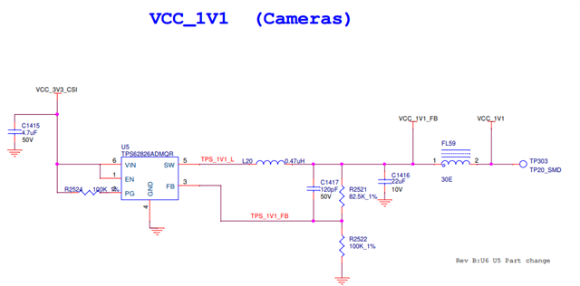

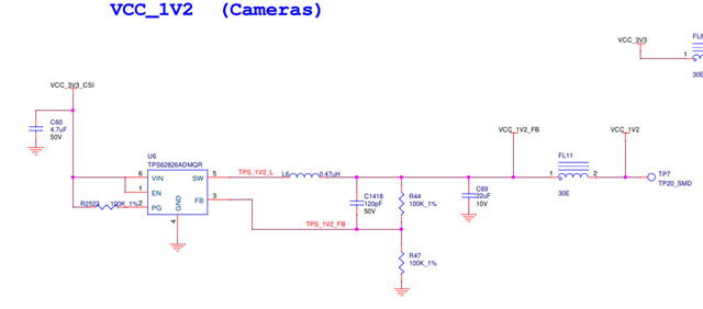

Hi team,
EN pin should be pulled high or low?
Kindly verify the design of buck regulator for 1V1 & 1V2
Lets know the inputs from you.

Hi Sathya,
The schematics look fine. The EN should be high to enable the device.
