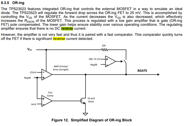

My customer is using TPS23523PWR.
They are looking for a product with the features below:

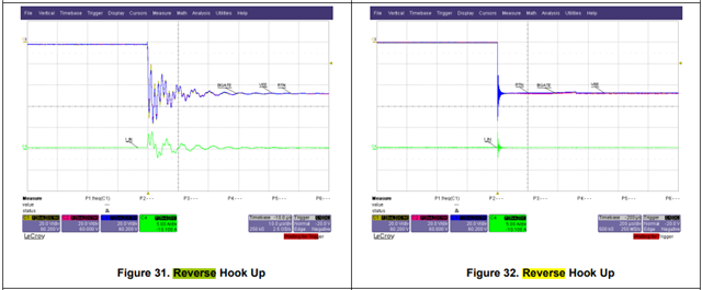

    - Reverse Current Blocking
    - Reverse Polarity Protection
Q1) If there is a product that includes the above features in the TPS23523 specifications that they are currently using, please recommend it.
Q2) Additionally, the customer is using the INA238 as a power sensor. If there is a hot swap controller product that includes voltage, current, and power monitoring functions, please recommend it.

  • Hi JH,
    TPS23523 can provide reverse current blocking and reverse polarity protection features. Please go through the datasheet in detail.
    For power and current monitoring, INA238 needs to be used in conjunction with TPS23523. We don't have any other hot swap part for -48 V applications.
