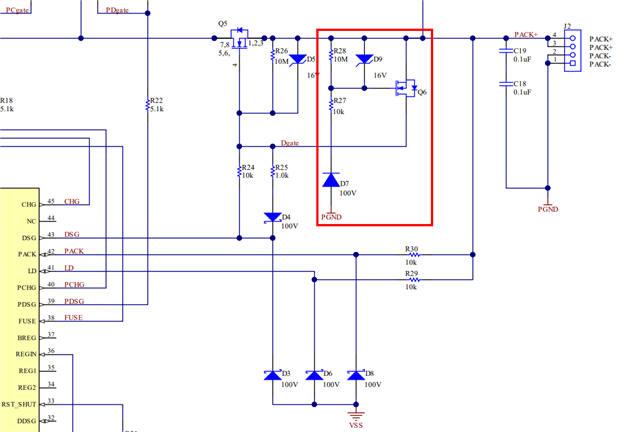

  • Hello Akilarasan,
    To clarify, do you want a reverse-charger circuit or a reverse-battery circuit?
    We have previously only implemented reverse-charger protection circuits. A common configuration would be something like shown here:
    PACK+/PACK- is where the charger would be attached to charge the battery. If attached backwards, the Q6 FET turns ON to clamp the voltage on the Q5 FET.  As to how this circuit would work, we have an explanation in Section 2 Reverse Charge Circuit and Section 3 Reverse Charge Component Selection of the Multiple FETs with the BQ76952, BQ76942 Battery Monitors application note. This is for a different device family, but the concepts of the reverse-charger circuit apply the same.
    I notice you have a similar circuit to this on your schematic. I would recommend to add a diode like the one I showed above to ensure the leakage current to ground is minimal. Also, with this circuit, there may be current flowing from ACDRV to whatever is connected to the drain of Q6 or Q7.
    Q9 would short the gate-source of the FETs, so now the ACDRV voltage can flow through the body-diodes of the N-Channel FETs.
    I am not sure if this much a concern. Jeff may be able to comment on that.

  • Hi Luis,
    Thank you for the reply. Could you also please explain me  about this following protection circuit, it is from BQ24171EVM-706-15V evm board schematic.
  • Hi Akilarasan,
    Q1 turns on and its body diode clamps the input voltage seen by the charger to no lower than 0.6V below ground.
    Jeff
