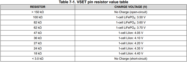

I found BQ25170 VSET table as below. If I need 4.28V charge, does it possible to adjust VSET resistor to maybe 25k?
or it fixed 4.2 or 4.35?
Or any similar charger can support 4.28V charge for LiFePO4?
Thanks!
Jeff

Hi Bill,
1S LiFePO4 battery, maximum charging voltage = 4.28V.
Charging current >500mA, HW standalone is better.
Thanks!
