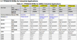

    Thank You for using E2E. TPS6521901/02/03/04 are pre-configured part numbers to power Sitara processors (AM62, AM64, AM243) for different applications use case. Here is a link to an application note that describes the differences: https://www.ti.com/lit/pdf/slvafd0. Table 3.1 shows a summary of the NVM configuration for each part number.
    The TPS65219 is a very flexible cost and size optimized PMIC that can be configured to power a variety of applications with TI and non-TI processors or SoCs. The TPS6521905 is the user programmable version that comes with all the rails disabled by default allowing customers to program the NVM memory (output voltages, sequence, etc) to meet the requirements of specific applications. Here is the link to the programming guide: TPS65219 Non-Volatile Memory (NVM) Programming Guide
