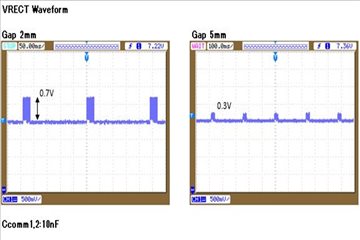

I have designed a custom board with  the BQ51013B.

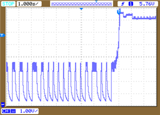

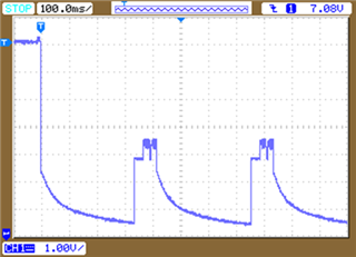

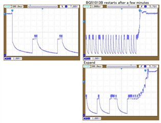

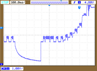

The board I made shuts off the output after several hours.
So I adjusted the capacitance of comm1,2 to 10nF and it no longer shuts off.
However, I am concerned that there may be other factors.
Please let me know if there are any other cases where the output gets shut off after a few hours.
The parameters I'm using are as follows.
COIL=Würth  760 308 101 214(Ls=26uF, Ls' = 31uF)
C1=78nF, C2=1000pF, Ccomm1,2=10nF
R1=75, Ros=20k, Rfod=200 (Ohm)
TS=Pull Down via 10kOhm
