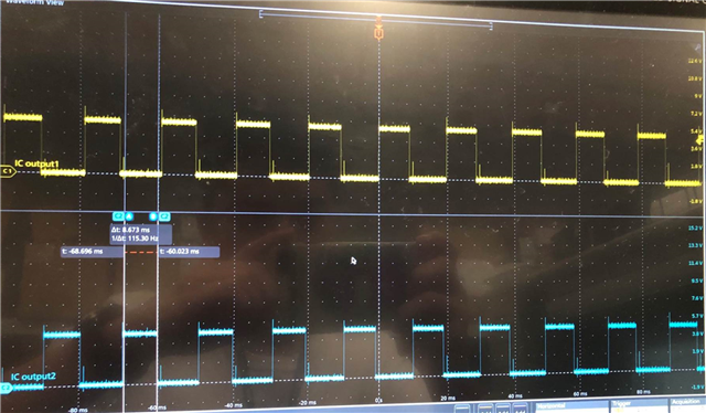

  • Hi Manuel,
    I don't clearly understand the calculation of the clk for the part.
    If we need 60Hz PWM signal(+/-180degree) with 3% dead time. How can we design CT and DIS pin R/C?
    Roy
  • Hi Roy,
    Use 1st order equations showed in pg. 7. Some considerations:
    -Tdischarge is the dead time between driver signals (OUTA and OUTB).
    -Oscillator frequency fosc is twice switching frequency fs.
    Parameters:
    fs=60Hz; fosc=120Hz; Tdischarge=(0.03)*(1/120Hz)
    Equations:
    1.36*Rb*Ct=Tdischarge
    5.9/[(Ra+8*Rb)*Ct]=fosc
    You can start setting Ra value and then calculate Rb and Ct values. One example for your case:
    Ct=200pF; Rb=920ohm; Ra=238.5Kohm
    Please, take into consideration that these values are within the range of +/-20% of the real values. Measuring the charge and discharge time at the SYNC pin is recommended to verify them.
    If you have any further questions, let me know replying to this thread.
