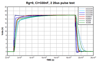

    Unfortunately we do not have every UVLO in every package in every conficguration for every UCC53X0 device. However, They are all very competitive device and are well known by our customers for their ruggedness and reliability. Compared to other drivers, they often have higher integrated output current into large loads, such as >10nF Ciss switches and parallel switch loads. Please see a competitive analysis measurement below, which highlights high output current and low propagation delay.
