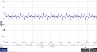

3. When 10mA flows through the load, a CS signal is input as shown below. What causes this waveform to occur?
* HW config
   - CS range 30mA, RCS --> 10K
   - CL 200mA , RCL --> 1.2K
Thanks.

    3. At 10mA, the accuracy is potentially +-15%. Please also check to see that the current through the FET is not behaving similarly. Further more, please test this device with real loads as eloads can affect the functionality.
