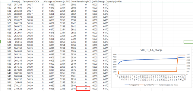

The customer use BQ40Z50 with two series cells, Term Voltage is 6000mV.
When the battery voltage exceeds 4.0 V (single cell 2.0 V) the Remaining Capacity will update when the voltage charge to 7.6V, sometimes even higher.
7725.gg.csv
LFA3-07-report (1).zipcharge log.xlsx
The smooth function is enable.
Attached the GPCCHEM report, log data and gg file.
Please give some suggestions.

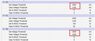

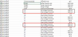

    1- The FD and TD thresholds might be set a little bit too high. Please set them to the below recommended.
    Recommended
