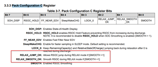

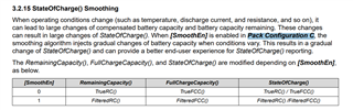

I have the same question - what is the resRelax time?
I have a fast discharge application and am having dificulty with Ra Table updates
Hi Reed,
These are private parameters.
ResRelax Time (default = 50s) describes how a specific cell settles for capacity simulation purposes.
SecRelaxTime (default = 30s). The gauge takes cell resistance measurements during discharge every
SecRelaxTime seconds. It will perform a linear regression through all measurements when DOD crosses a grid
point.
PrimeRelaxTime (default = 500s). The gauge will not start measuring cell resistance until this time has passed in
discharge state.
Jose Couso
In some cases our full discharge will be completed in under 500 seconds. In the case of discharge longer then 500 seconds, the pack will be deep into DOD before the first Ra table update occurs - past early grid points. how do you suggest we tweak these parameters to ensure Ra updates occur.
Hi Reed,
You can write and read from this parameters in data memory. Please provide BQZ file you are using and I will tell you the exact location in data memory.
Or you can provide the following three.
Looks like lowering PrimeRelaxTime might be helpful in your application.
Jose Couso

Hi Jose,
I was able to do more testing and watched real time as RA table updates were made during during discharge. The discharge progressed to Grid Number 7 (SOC about 33%) on the Ra table, when the cell voltage began to quickly drop below the term voltage (due to low cell health on one cell) - the Bq40z100 set the SOC to 0% and it looks like grid point 8 on the Ra table was updated and FCC dropped to a value close to the energy that was pulled out during the discharge (all good to this point).
However, the next morning(after the battery relaxed overnight) The full charge capacity jumped back up to the previous, value before the discharge (way more energy than is acutally available in the pack).
My question is:
1. in cases where the term voltage is reached early due to a weak cell, prior to the later Ra table grid points being hit (SOC 33% in my case), how do the RA table updates occur for those later grid points?
2. Any thoughts on how to prevent the FCC from jumping back up after relax, after term voltage is reached?
Reed
Hi Reed,
1- If the "later" grid points are not reached, then they will not be updated. The gauge runs simulations at each grid point.
2- Set RELAX_JUMP_OK = 0 and RELAX_SMOOTH_OK = 0 flags in your PACK Configuration C Register. See below
Jose Couso
