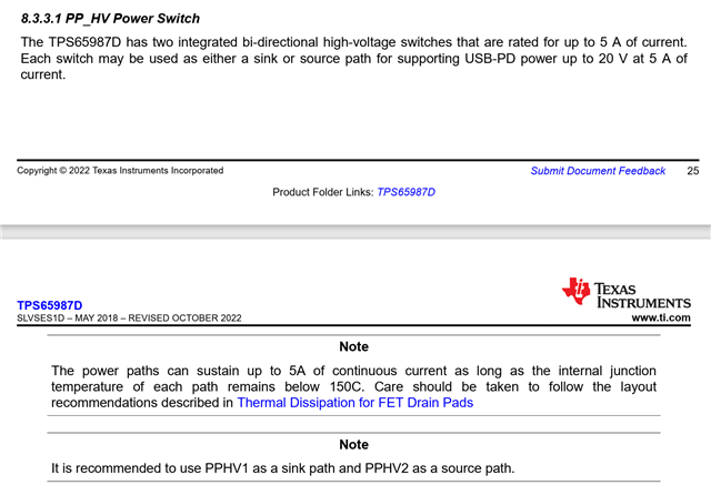

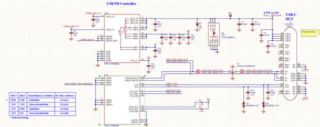

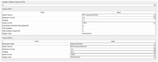

The data sheet shows a power only battery charger application configuration where both internal switches can be used to initially supply 5V and then negotiate 20V source for battery charging. We are running into software difficulties getting this to work. Is this a valid configuration that is supported? Is a specific BQ battery charger required for this configuration?
