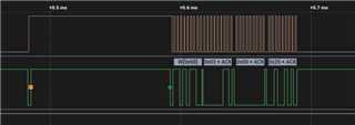

I'm encountering an issue with the TPS25750 regarding charging the battery with the BQ25731 IC.
When connecting to a Power Delivery charger, the contract is negotiated correctly. Charging works as expected (over 2 Amps). However, after reconnecting to a non-PD charger or a PC, the I2C_m clock line is held low. Communication over I2C_s still works, and registers can be read.
However, after reconnecting back to a PD charger, the I2C_m clock line is still held low, and the charging current is stuck at around 200 mA. At this point, only resetting the TPS25750 seems to release the I2C_m clock line.

I've also attached some I2C logs to provide more context and data.
