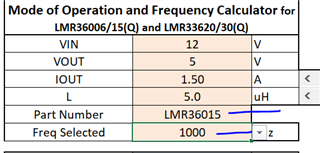

From section 8.4.4 of the datasheet, "When either the minimum high-side switch ON time tON_MIN or the minimum peak inductor current IPEAK_MIN (300 mA typical) is reached, the switching frequency decreases to maintain regulation."
I can't find any other reference to IPEAK_MIN in the datasheet. Is there a specified min and max value of IPEAK_MIN?
