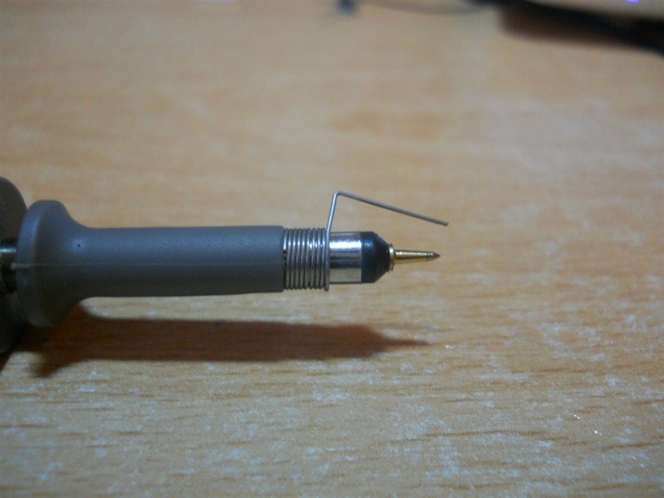

The undershoot of the SW and BTST terminals is lower than the absolute maximum ratings, but is it correct that this regulation is for externally applied voltage and does not apply to the undershoot that occurs during switching?
I have attached the measurement results, so please check them.

  • Hi Kagawa,
    Did you measure the undershoot with a ground spring like below:
    If not, the measurement might be a bit exaggerate due to long ground return pick up.  Even then, the datasheet abs max are tighter than what the IC can withstand.  If you are concerned, you can add a Schottky diode from SWx to ground to clamp that node to 0.3V below ground.  Those diodes will also boost efficiency by up to 0.5%.

  • Hi Kagawa,
    The short duration undershoot < abs max(min) rating on SWx and BTSTx should not cause long term damage.  Did you follow the recommended PCB layout in the datasheet and EVM user guide?
