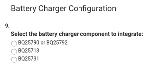

We are using TPS25750 + BQ25792 with 2cell battery(bq40z50).
This 2cell battery's output voltage will be zero when it is over discharged because of its inner protect IC(bq40z50). This battery supports 0V charging, it will be recovered from 6V+ charging voltage.
So my question is does TPS25750 + BQ25792 support 6V+ charging voltage to recover the 0V battery?
