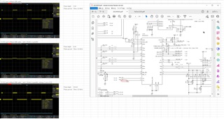

I design my circuit board for USB Type-C interface with HD3SS3220, and checked the waveforms and functions. And I found some strange behaviors on CC1, CC2 ports.
I design my board as UFP and set the ports as below, (I attach a part of schematic)
PORT: GND, ENn_CC: GND
Now I do not connect any USB cable, i.e. CC1 and CC2 are opened exclude ESD passive device on them. I think each of CC1 and CC2 have internal pull-down resisters, around 5kohm for detecting Type-C rotation, however I observed 4.5V pulse with 80ms period. I show it as (1) in attached jpg file. It looks that there is no pull-down resistor. I tried to add 4.7kohm externally between CC1 and GND, then pulse level down to 344mV. Those are showed as (2) and (3). So I think there are no internal pull-down resistors. And this 80ms period noise appears on VBUS in some condition, of course with no USB connection. I guess it is caused by any noise conduction.
Is there any mistake of my design, or  is this behavior natural?

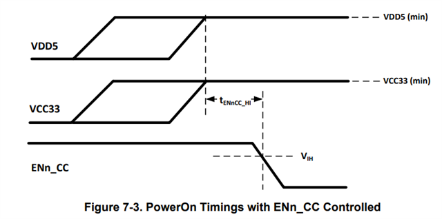

    That is strange, can you send the waveform for your voltage rail startup on the 5V and 3.3V?
    Can you also send the waveform of the USB VBUS?
    Are you able to control when ENn_CC goes low?
    > If you can, have ENn_CC go low at least 2ms after the 5V and 3.3V rails are stable. Refer to the timings table in the datasheet:
    Shane
  • Hi Shane,
    I took a waveform of VDD5 and VCC3. Yellow CH1 line is 5V and pink CH2 line is 3.3V. 3.3V rises up after 300ms from 5V rises up. This sequence is controlled by timing-sequence device.
    And I also checked ENn_CC control by manual according to Figure 7-3, you showed. As I controlled by manual, TENnCC_HI would be a couple of seconds. And result was same. It appears pulse wave on CC port.
    Terry

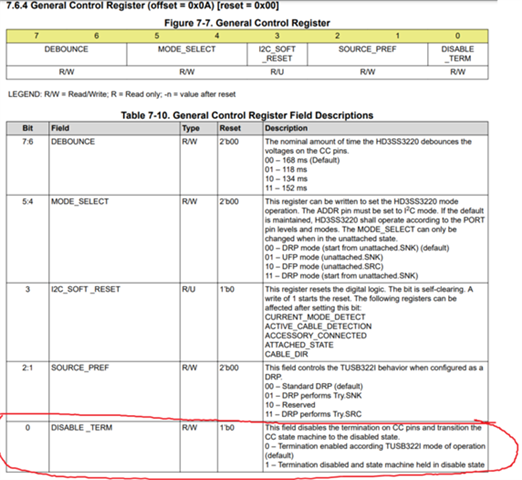

    There are a few debug tests in I2C that could help if you can provide the waveforms for them. Try doing these steps while no USB is connected.
    First make sure to write ‘01’ into the I2C MODE_SELECT register. This will override the PORT pin and force the 3220 into UFP mode. After this, confirm whether the CC pins are still pulsing. Then try the following tests.
    1. Try Disabling the CC terminations in I2C mode, then performing a soft reset:
    • To do this, write a 1 into the DISABLE_TERM register, observe the waveform on CC pins, then write 1 into the I2C_SOFT_RESET register. Is there any change in the behavior of the CC pins?

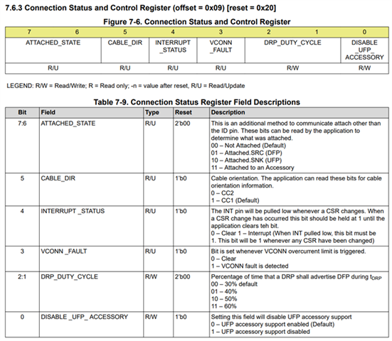

    2. Try disabling the UFP accessory register and observe the waveform
    • To do this, set DISABLE_UFP_ACCESSORY to 1

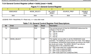

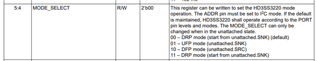

    Although I told that it worked fine with I2C control, it would not be correct. It still remains High/Low behavior on UFP mode.
    I would confirm that, the data sheet would be incorrect on the description for 7.3.2 UFP. It would be copy of DFP description. So is it fine the manner as below?
    1. Write a 1'b1 to DISABLE_TERM register (address 0x0A bit 0)
    2. Write a 2'b01 to MODE_SELECT register (address 0x0A bits 5:4)
    3. Write a 1'b0 to DISABLE_TERM register (address 0x0A bit 0)
    Does it need any further step?

    Your procedure is correct, write a 2'b01 to the MODE_SELECT register for UFP mode.

  • Hi Shane,
    I might make sense for these behavior and situation.
    Although I reported that it appeared High/Low toggle behavior even on I2C on my previous post, I did not set "DISABLE UFP ACCESSARY" and Accessary support was enable. In this case, does it appear toggle behavior for detecting if a connected material is accessary or not? When I set "DISABLE UFP ACCESSARY", it disappeared toggle behavior and CC port was always Low.
    In GPIO case, it cannot set accessary disable, so the toggle behavior would work for accessary detection.
    Is it correct?

  • Hi Terry,
    I verified this behavior on the validation test setup and see that setting the DISABLE_UFP_ACCESSORY register seems to fix the toggling. I believe the way the HD3SS3220 implements accessory support may be interfering with its ability to present pulldowns.
    Are you able to use I2C mode in your application and set DISABLE_UFP_ACCESSORY? So far this is the only workaround we have seen. I am continuing to work with our systems team to confirm the cause of this behavior.
