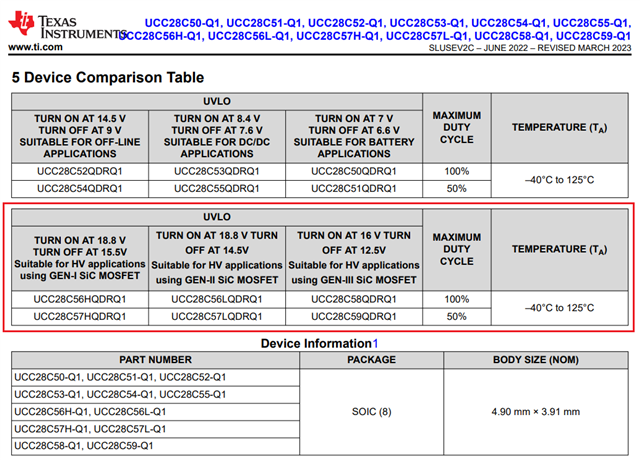

We are looking for a switcher IC's for MOSFET below spec for SEPIC topology
input voltage :- 75V to 1000V DC
Output Voltage :- 400V DC
Output Current :- 300mA
Efficiency >94%
Give suggestion for selecting the right topology, both isolated and non-isolated are also okay.

    I don't see a reference design for your exact specs but here are a couple design resources to help move you in the right direction:
    1. Search TI Reference Design library here.
    2. Download and use TI Power Stage Designer to evaluate and compare the performance of various proposed topologies
    3. For 1kV input, are you considering to use SiC MOSFET? If so TI has recently introduced the UCC28C5x general purpose PWMs which are upgrades of the industry standard UCC28C4x family. The UCC28C5x controllers highlighted below are tailored for SiC MOSFET applications. There is also a wide input voltage flyback EVM available which is operating from 40V<VIN<1kV.

    Input voltage range is from +75Vdc to +1000Vdc. It is in positive range only.
    Application Auxiliary supply for Solar Inverter.
    Output voltage :400Vdc @ 350mA.
    Please suggest preferred topology to achieve from your end. Also please help us with simulation model for the suggested UCC28C58.

  • Consider the flyback I mentioned previously:
    1. For 1kV input, are you considering to use SiC MOSFET? If so TI has recently introduced the UCC28C5x general purpose PWMs which are upgrades of the industry standard UCC28C4x family. The UCC28C5x controllers highlighted below are tailored for SiC MOSFET applications. There is also a wide input voltage flyback EVM available which is operating from 40V<VIN<1kV.
