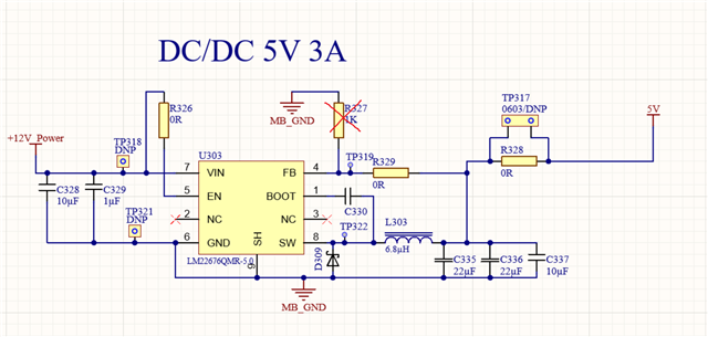

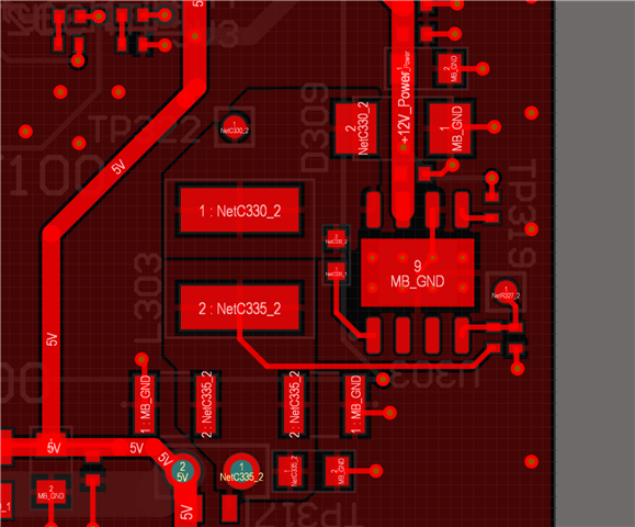

I'm using LM22672 fixed 5V output for my design.
12V input.
Supplying 5V on the board separately, the load is about 0.5-0.8A. However when using the LM22672 the switcher gets to hot. About 100degree Celsius.
Do I need a different inductor? Any suggestions would be appreciated.
