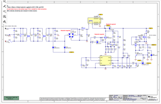

Hi Ulrich ,
I am very much thankful to you for reply and sharing the valuable information.
Now we are using UCC28056DBV as per PMP21160 from TI, (Rev B) for 50Hz PFC.
Same thing attached here and same components we are using for 50Hz.
Please let us know the which components we have to change to get 400Hz PFC circuit?

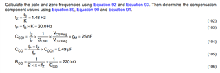

Hello Santhibhushan,
Uli is out so I will cover for him. To reach the 80Hz crossover frequency that Uli mentioned you will need to adjust your COMP values, specifically Rco (R123), Cco (C118) and Cco1 (C120). Please follow the Voltage Loop Compensation section on page 40 of the UCC28056 datasheet (https://www.ti.com/lit/ds/symlink/ucc28056.pdf).
Repeat the same steps from page 40-42 to find the 3 component values except set Fb as 80Hz. The datasheet example uses a Fb of 6.66Hz.
