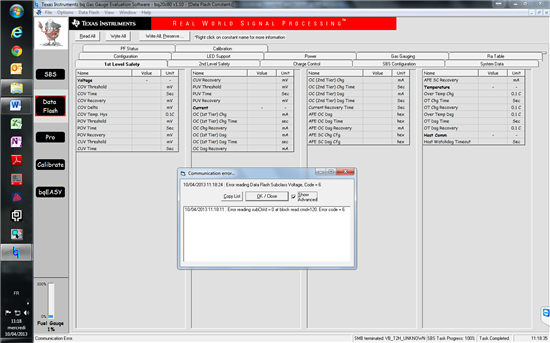

bq20z80 and bqeasy communication error. SMB terminated:VB_T2H_UNKNOWN
Other Parts Discussed in Thread: BQ20Z80

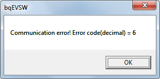

hello everyone!
 My bqeasy and bq20z80DBT communication error.
Please help me.Thank you!

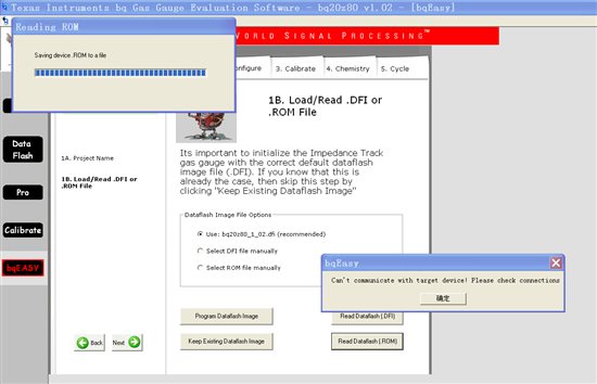

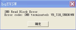

    Looks like you are not communicating properly with the bq20z80 - It maybe in the sealed state. bqEasy during its operation tries to access the DF - which is not accessible sometimes (depending on which device) - If it is not able to do so, it outputs similar error. Both errors point to same symptom - either device is sealed or in a mode you cannot communicate with it. Try reprogramming the part fresh and ensure you can communicate properly ( you can read both SBS and DF screens ).
    Sambit
  • Your gauge is sealed. You will need to send the unseal keys to Manufacturer Access to read extended SBS commands and data flash. Reprogramming firmware will not work in the sealed state.

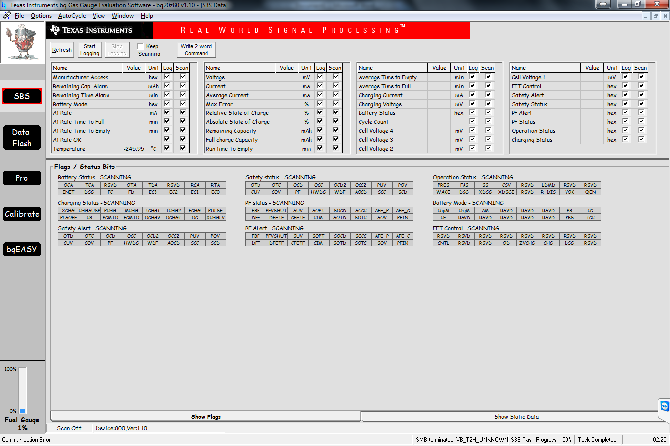

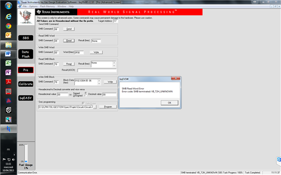

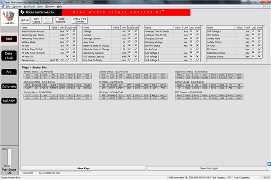

    I have essentially the same problem. I will present my print sceens :
    After a attempt to read or write on a register:
    After a attempt to program on a file .senc:
    And after to read Data Flash:
    This behavior occurs after writing a .DFI.
