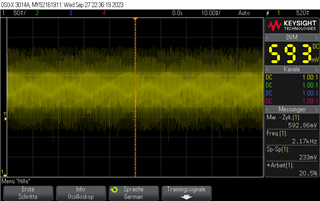

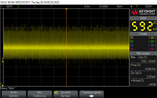

In the following u can see the signal measured across a resistor that is right before the LEDs (27uF left and 10uF right used as inductors in the circuit).
As you can see there is a high frequency noise with a max ripple of about 150 mV. (I also tried 39 uF but it doesn't get much better)
Now my question is: Is this to be expected from the TPS922053 or is this fixable to a degree by changing the overall setup.

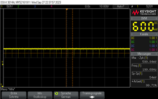

  • Just so you get a better Idea what I mean. Here is the same measurement on with the same LEDs and similar power output with the ADP8140 form Analog Devices as LED Driver.
    Can i get a similarily "clean output from the TPS?
