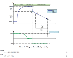

After sending 0x23 (learning cmd )  learning is started and also completed successfully.  After learning is done capacitance is changed to 50F and (initial and design capacitance is 10F). How to verify  the capacitance in theoretically using the learning graph.
In the below image , How the  points A, B , C and D are plotted ?

    The gauge is constantly measuring voltage and current, so it will have all these data points to do the analysis on.
    The graph has the equations at the bottom used to estimate capacitance. If you are just trying to verify capacitance there are multiple different methods to check the calculation.

    1. We are having 5 capacitors of each 10F capacitance , so the total  capacitance is 10F (50F/5) ,  After learning the capacitance is increased to 50F , what is the mistake I am doing here ?
    data flash settings for learning
    Learn Delta Voltage    1000mv
    Design ESR , initial ESR, ESR      110ohms
    Design Capacitance , 1st Capacitance , Capacitance    10F
    V Learn Max 10730mv
    still any other data flash settings are required ?

    1.And I have one more  doubt  what  voltage value should I need to configure to the V Learn max  with respect to my capacitors( Number of  capacitors all are in series = 5 ,individual capacitor voltage = 3V , Stack voltage  = 3 x 5 =  15V)  ? .
    2.Currently I configured the V Learn max as 10730. It should be 15000mv ?
  • Hello Karthick,
    It should be set for your max charge voltage, it seems this would be 15V for you. Are you only charging your 3V capacitors up to 2.15V?
