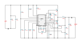

I needed to convert a 12 VDC to -65 VDC, 2A using Webench Power Designer. It gave me a schematic based on an LM5116 converter. However, when I try to simulate using TINA-TI, the simulation runs into a convergence issue.
here is the schematic and the simulation file:

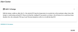

Here is the alert generated by Webench Power Designer

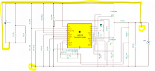

Here is the simulation file:
LM5116_-65V_Simulation.TSC
How best can I go around this?
