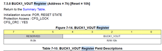

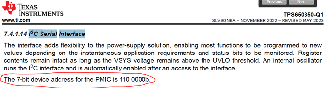

1. How do we know what the TPS650350 I2C Slave address is?

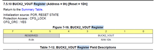

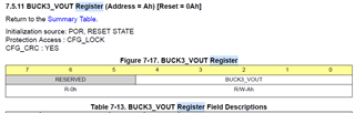

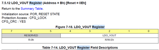

2. If we would like to read TPS650350 register's address. How to command it? Currently, we would need to read Buck1_VOUT Register, Buck2_VOUT Register, Buck3_VOUT Register and LDO_VOUT Register. As I know that we can read address's register value directly by I2C. but I'm not sure what kind of command to read those address.
