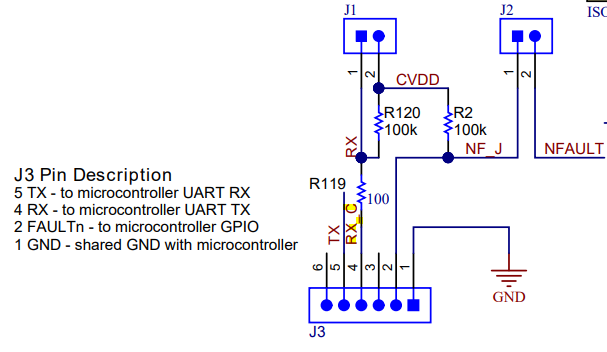

I am designing a BMS with the BQ79616 and I'm currently setting up the UART communication lines, specifically for the RX pin.
Based on the datasheet's instructions:
"The UART interface requires that RX is pulled up to CVDD through a resistor on the base device. The RX is pulled up on the device side. Do not leave RX unconnected. Ensure RX is connected directly to CVDD for stack devices."
I am seeking clarity on the following:
  1. Should I pull up the RX pin directly to CVDD without a resistor, or should I use a resistor for the pull-up?
  2. If a resistor is recommended, what would be the appropriate value for it? Would a 100k resistor be suitable?
Thank you for your guidance on this matter.
My design is below.
Best regards, Batuhan
  • Hi Batuhan,
    A resistor is recommended if you intend to use RX and TX for UART communication. Shorting RX to CVDD will disable the use of RX and TX pins for UART.
    A 100k resistor is suitable. On the EVM, we use a 100k resistor between RX and CVDD. To disable UART, the EVM has Jumper J1 which can short RX and CVDD when populated.
    David
  • Thank you for your response. I referance EVM. what about RX MC can you explain the 100R?
  • Hi Batuhan,
    If you are referencing RX_C:
    This is because J3 is for an FTDI cable which is a second way to talk to the EVM. In the case that the user is using both a USB2ANY and FTDI cable, the 100 ohm resistor is to limit the current between the two voltage sources (USB2ANY's 5V line & FTDI's 5V line). If you are using only 1 form of UART communication, then you do not need this resistor.
