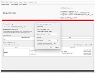

    Can you show me how you ended up trying to flash the EVM?
    Are you selecting flash from current project?

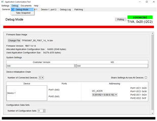

    Are you getting this error when you enter debug mode?
    Entering debug mode is a way in which we allow our customers to both debug and in live time change register values that would emulate what they would do with an EC.
    Please let me know if you are unable to enter debug mode and change the register values (This would be equivalent to writing I2C).

    The issue that you are having is regarding to writing to the device while it is in app mode to change device settings "on the fly" as your EC would in your final system. Please let me know if I am interpreting that part incorrectly. I just reached out to the team that handles the TIVA firmware as this was written with another team, however I do have a workaround regarding this issue.
    The debug mode in the GUI allows you to see all the device settings in real time. This allows you to also change the device settings in the RAM as you would with an EC.
    For example lets say that I initially flash the device with 1 sink PDO which is offered at 5V @ 3A. When entering debug mode, I can add additional sink PDOs just like an EC would that would then have the device offer whatever you contract I would like.
    The difference here is that you would be making the changes 1 by 1 rather than a complete feature set like you would with the write config to device feature in the GUI.
    Let me know if you are able to do this!

  • Hi Kevin,
    Thank's for your reply. I am able to, for example, flash from current project on the TPS65988DJEVM, but I cannot on the TPS65988EVM. The failure message indicates it failed to erase flash. I also cannot erase flash manually.
    Using the TIVA interface, I entered debug mode and disabled a port. When I imported the settings from the device, the port was no longer disabled. I did not reboot the device during this test.
    Roy
