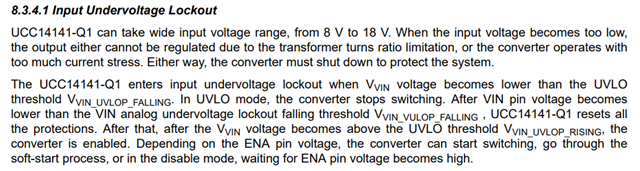

(1) What happen on its output voltage / output power / operatoin in the case input voltage becomes 6V?

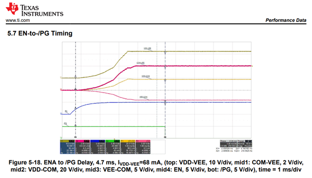

(3) Do you have EN signel respons time until output voltage is in steady state? Figure 8-5. Output voltage Soft-Start Diagram shows timing diagram but does not include respons time (ms). Is it depending on how much COUT2 or COUT3 is used?

    (1) What happen on its output voltage / output power / operation in the case input voltage becomes 6V?

    (3) Do you have EN signal response time until output voltage is in steady state? Figure 8-5. Output voltage Soft-Start Diagram shows timing diagram but does not include response time (ms). Is it depending on how much COUT2 or COUT3 is used?
    • UCC14141EVM-068 User Guide, Figure 5-18 shows EN to /PG delay measured as 4.7ms. From the scope plot below, the time from EN to both output reaching steady state is ~3ms.
