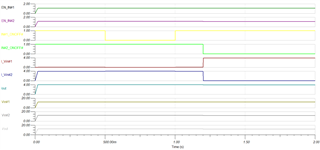

I'm using two TPS25940-Q1 in the below matter to switch between two power supplies.
It seems that when both input are present at the same time, then one of them is disconnected, its corresponding e-Fuse stays latched and the output voltage from the second supply is then transferred to the input.
Similar results of this simulation were observed during testing.
Note : IN#1)= 12V < V(IN#2) + 66mV = 12.15V
- Is there a way around this issue by implementing minimum change to the above circuit ?
Thanks in advance for the support.
