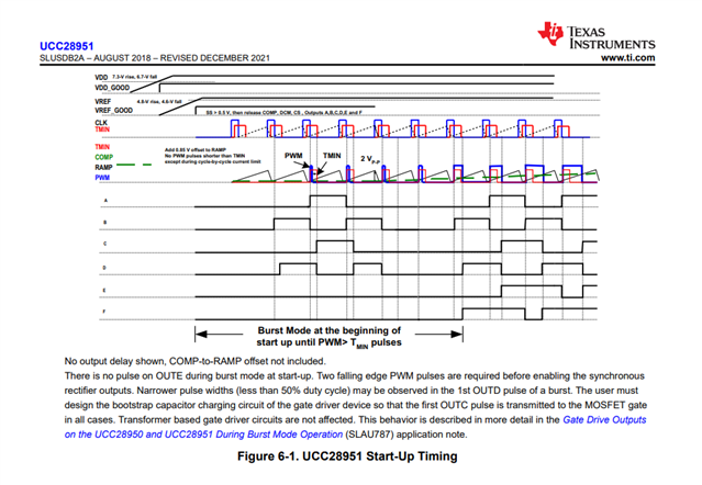

How to cancel burst mode during soft start
Other Parts Discussed in Thread: UCC28951, UCC28950
Please explain the operation of TMIN "Minimum duty cycle programming in burst mode.
I have set up a soft start at startup, but it goes into burst mode even though it is in soft start. Is there any setting that does not cause burst mode during soft start?
Condition
Soft start: approx. 120 ms
TMIN resistance: 10kΩ
It is not in hard switching without partial resonance to be in burst mode.
