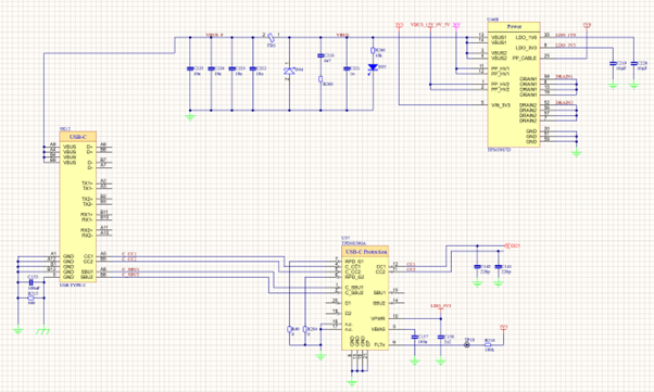

Dear Support Team,
I am using the TPS65987DDH as a DFP and have configured both PP_HV1 and PP_HV2 as Sources. The 5V, 9V and 15V rails are sourced from a DCDC converter, whilst the 20V rail is sourced directly from the system power.
See attached image with schematic.
The device is configured to source 20V from PP_HV1.
I am however having issues with this setup. It negotiates a power contract for 5V, 9V and 15V OK, but it doesn't negotiate a power contract for 20V.
Can you please tell me where I may b going wrong?

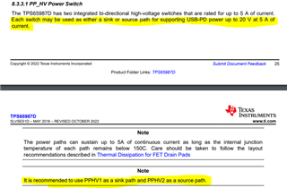

The datasheet "recommends" that PP_HV1 is used as a sink but it doesn't give a reason and the configuration tool allows you to setup PP_HV1 as a source.
I'd appreciate any help you can provide on this subject.
