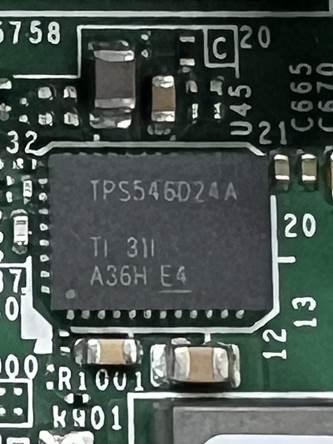

Hi Team,
Regarding the TI TPS546D24ARVFR part
We are using materials from two different date code and have observed a power-on issue
2023/5/19
2023/8/21
The client is suspecting that 0xED default value is different, they saw 5/19 was 0x0002 and 8/21 was 0x0000
  1. What the 0xED default value is?
  1. Is there different between 2023/5/19 and 2023/8/21?
  • Hi Gary,
    The default value should be 0x0000h as specified in the datasheet.
    There should be no difference between these two parts.
    Did these devices come from a 3rd party for programming purposes? Or did they come directly from TI?
    Did the customer change the EEPROM settings over PMBUS?
