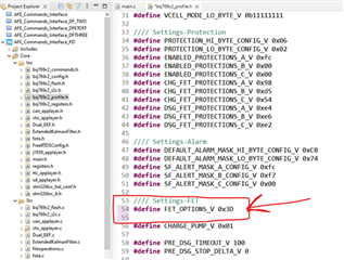

The same settings have been applied in the firmware as well and this is shown in Fig 2.
Fig 2. Applied settings for the FET control from the firmware shows 0x3D
The logical implementation in embedded C language has been shown.

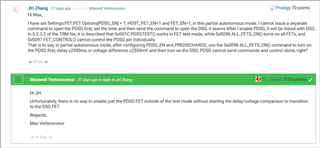

However, the PDSG MOSFET is not turning ON as intended as we were not able to detect any gate pulse being sent from the AFE. The code has been de-bugged several times and the MCU is executing all these lines successfully.
The E2E forums hosted by TI mentions that the PDSG mosfets cannot be individually controlled as shown in  Fig 3. This is where we require assistance.
Fig 3. TI E2E forums discussing the pre-discharge capabilities.
We sincerely request your help and support in this regard.
