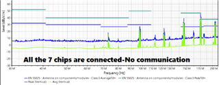

I am using BQ79616-Q1 in my BMS PCB.  All the functionalities are working as we expected. But the problem is its failing in EMI test (CISPR-25). My observation is that for every 25Mhz frequency(periodic), noise amplitude is shoot up 30dbuV/m to 40dbuV/m.

    I am using six Bq79616-Q1 and one Bq79656-Q1. Total seven IC's. These are in stacked in series to achieve the required load voltage.
    Here, Bq79656-Q1 is base device and Bq79616-Q1 is connected one above the other.

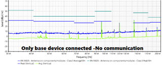

    Yes, we have conducted testing both with & without communication.
    Sharing the waveform below for more understanding.
    above test repeated to higher frequency also, same shoot-up observed for every 25Mhz.

    My MCU and base device is completely isolated with each other, it is having separate power supply, ground plane and isolator IC used for communication. By Turing off MCU and only balancer IC power ON also am getting an issue.

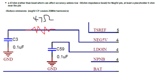

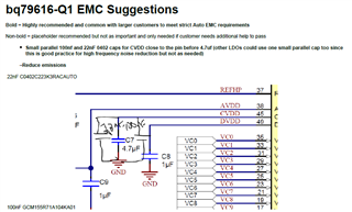

    I think add a resister on the NEG5V can solve the issue. The smaller the resistor value, the better. Large resistance values may affect accuracy.
    Small parallel 100nf and 22nF 0402 caps for CVDD close to the pin before 4.7uf (other LDOs could use one small parallel cap too since
    this is good practice for high frequency noise reduction but not as needed)
    –Reduce emissions
    22nF C0402C223K3RACAUTO
    100nF GCM155R71A104KA01f
    a 47ohm (rather than bead which can affect accuracy unless low ~80ohm impedance bead) for Neg5V pin, at least a placeholder 0 ohm
    near the pin
    –Reduce emissions (neg5V CP causes 25MHz harmonics

    Small parallel 100nf and 22nF 0402 caps for CVDD close to the pin before 4.7uF. This measure is added together.
    These change are useful for my customer. Check other capacitors  are the same as recommended.
