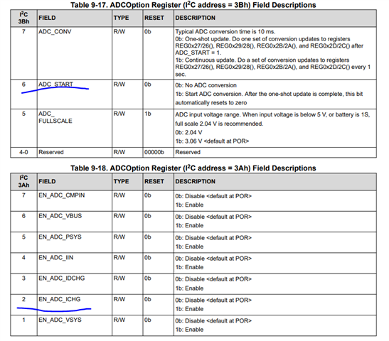

We are using BQ25713 charger for our product,
It is charging battery and we are able to measure battery voltage.
But we are not able to detect battery removal.
We tried enabling ADC
Reg 0x3A = 0xFF
Reg 0x3B = 0x80
And tried measuring the ADC VBAT
Reg 0x2C = 0x15 // with battery connected
Reg 0x2C = 0x15 // with Battery removed
How to detect battery has been removed?

  • Hello Justin,
    In order to detect battery removal please measure the battery charging current. Enable, ADC_ICHG and ADC_START then measure the charging current by reading register 0x28. After battery removal it will read charge current as zero. When reading the current make sure that charge current limit in register 0x02 is set to something higher than zero current.
    Munir
  • Hi Munir,
    Thanks for the feedback.
    We have already tried this and its not helping.
    Actually our system is always connected over USB and runs on VBUS power. Only in case of surge cases the power gets drawn from Battery(500 mAH)
    Since the system is operating within 500mA which is completly supplied by USB and Battery is fully Charged there is no Charge/Discharge current.
    Hence Register 0x28 and 0x29 are both 0 with or Without Battery connected.

    Please let us know in this scenario how to detect Battery removed consition?
    Justin
  • Hello Justin,
    This part does not have a battery detection feature with software. One workaround was to measure the charge current but this is not possible in your scenario. You need to pull the CELL_BATPRESZ pin low to indicate battery absent. Hence, you need external hardware logic to detect battery removal and pull CELL_BATPRESZ pin low.
    Munir
