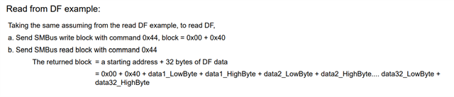

I'm trying to access the data flash memory of the BQ40Z80 via SMBus. In order to do so I'm referring to the Technical Reference Manual (rev.C) page 146-147. This is what I've found for the data flash access memory:
I'd want to get information from the register 0x4CE9 (Temperature Threshold), thus I wrote the following code:

During the writing, the device doesn't acknowledges maybe because I misinterpreted the procedure. Can you please examine the code and tell me if anything is wrong on how I'm asking informations to the BQ40Z80?
  • Hi Luigi,
    We do not read code. Instead please try this sequence.
    1- SMB_write_block (device address, command, length)
    2- SMB_read_block (device address, command, length)
    Device address = 0x17
    command = 0x44
    length = it depends, for writing 2 bytes. For reading 34 bytes is the whole block.
    See below an example.
