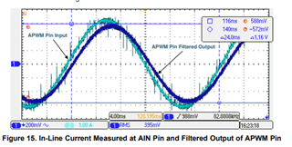

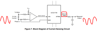

UCC21755-Q1: AIN pin
Part Number: UCC21755-Q1
Is it possible to use the UCC21755-Q1 AIN pin to sense output ac voltages or currents, also what are the other use cases of the AIN pin except dc-link voltage sensing and temperature sensing as I see the input voltage is limitied to only positive values. Can you please share some reference design in the case ac quantities are measureable through it.
