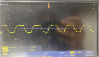

    But i have one concern the gate resistor package is 0603 and value is 10ohm and changing to 50ohm can you tell me the formula for calculating wattage for base resistor, i have seen lot of formula but it will not help in my case.
    I am attaching image for Gate pulse can you check it' s ok.
    Waiting for your valuable feedback.
    Pankaj
  • Pankaj,
    The power loss in the gate resistor is minimal for your application and a 603 package is fine for 50 Ohm gate resistor.  You can measure the voltage differentially across the resistor and calculate the power loss if you want.  This is the easiest way of doing it.
