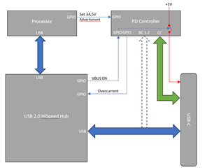

    I've made a small block diagram to show our current idea:
    We one GPIO of the PD will be used to switch the power advertisment between 900mA and 3A @5V. The other two are the signals from the hub. The power enable shall control the switch in the sense, that it only shall be enabled when the enable signal from the Hub is high and a sink is attached.

    The PD controller (TPS25750) will handle all the power side of the USB Type-C port. In the event of an overcurrent TPS25750 will automatically disable the power path by opening the switch, this does not require an external control from the HUB to set.
    TPS25750 will automatically advertise the Type-C current of 3A upon a connection of a sink device. As mentioned in the previous statement above, the PD control automatically controls the switch (internal to the PD control) based on its state. The PD controller doesn't require external control to enable/disable the power path or start sourcing.
    Sorry, I meant the Fault_Input_Event. Could this be used as an enable signal?
    When the Fault_Input_Event is triggered (set low), the PD controller enters the Type-C Error Recovery State. Doing so will reset the PD controller and restart the PD negotiation. If there's a device connected, TPS25750 will notify the connected device it's entering a recovery state.

  • Hi Raymond
    Ok if an Overcurrent Event happens, will it re-enable the power path after a certain time or is a I2C command necessary?
    Ok but the TPS25750 can use a GPIO to switch between both advertisments?
    I'm also currently looking into the TP65988 (as we have dual USB-C). It seems to me, that it's quite similar to the TPS25750 and a GPIO can be used to limit the current to 5V @900mA. Is there any major difference from the point of view of functionality?

  • HI Sebastian,
    When an Overcurrent Event occurs, the PD controller will re-enable the power path after a certain time.
    If you're referring to just Type-C Current (no PD) then you'll need to adjust the Type-C Current Advertisement in Port Control Register (0x29). For PD connections, TPS25750 will automatically advertise and negotiate with the connected sink device.
    TPS65988 is a dual-port solution with more features and capabilities such as Alternate Modes, DisplayPort, Thunderbolt, etc. TPS65988 comes with two high-voltage power path per port that can be configured for either source, sink, or DRP. There are also several more GPIO events to use, refer to the Technical Reference Manual for more details.
    All other PD features (such as CC detection, power negotiation, etc.) are all handled by the PD controller in the same fashion as TPS25750. For more information, we have several resources here: https://www.ti.com/product/TPS65988
