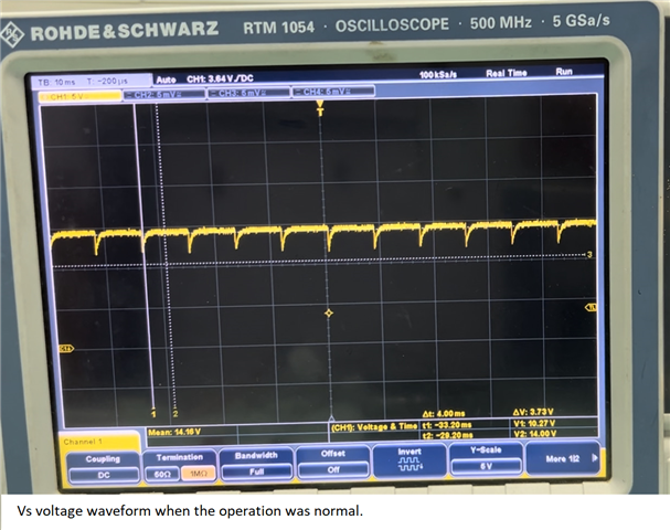

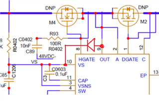

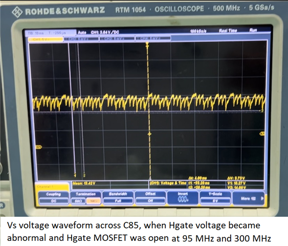

We are using LM74800QDRRRQ1 in our ongoing project of 300 watt 48 to 14V DC DC converter. The LM74800QDRRRQ1 is used to drive the back to back N-MOS connected at the 14V output of DC DC.
Below is the schematic. The Vs voltage waveform is shown below in both the cases of normal and abnormal operation (BCI test failure at 95 and 300 MHz).

  • Hi Ajit,
    Please test again with a diode added in between common source point and VS pin as shown below. This helps provide a low impedance path to the VS pin which provides power to the internal circuits of the IC.
