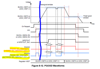

Question1:
GPIO9 is used as PGOOD in order to monitor with other devices that the PMIC has completed power output.
PGOOD is outputting H regardless of the state in which BUCK/LDO is not output (0V).
It has remained high ever since VCCA/VIO was turned on.
I understand that PGOOD=H if the output voltage is within the OV/UV threshold, but is this correct?
H/L does not change as shown in Figure 8-12.
Address setting are follows:
0x078 0x02
0x079 0x00
0x07A 0xAA
0x07B 0x88

  • Question1:
    To use PGOOD in this manner, set PGOOD_SEL_NRSTOUT =1. Your current setting have it set to 0 and PMIC is behaving according to the blue line in Figure 8-12. You want it to to behave according to the red line.

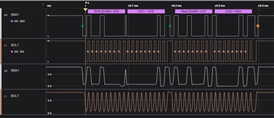

    Question 2:
    The PMIC is accessed from the control device via the I2C bus (without CRC).
    I am able to write to the register without any problems, but the PMIC is returning a NACK.
    Reads the written register and confirms that it was written correctly.
    Can this NACK be ignored? Or should I treat it as an access error?
    If you are seeing something similar to this at the end, then you it can ignore it.
  • HI Michael,
    As you pointed out, it worked fine when PGOOD_SEL_NRSTOUT_SOC=1.
    (I used nRSTOUT_SOC because nRSTOUT is used for other functions.)
    Question 1 is solved, thank you.

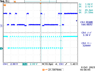

    About Question2:
    The attached waveform is for Read Cycle, right?
    It has been confirmed in the data sheet that a NACK is returned during Read Cycle.(Figure.8-59, 8-60)
    What I'm concerned about is Write Cycle.
    What are the possible causes of a NACK being returned during a Write Cycle?
    Thank you.
  • The attached waveform is for Read Cycle, right?
    Yes, that waveform represents a read cycle.

    Can you provide a scope shot of the write cycle including the NACK?
  • This waveform is when writing 0x81 bit0 to 1.
    The cursor on the right shows NACK.
    Before this waveform, 0x9B is written to address 0xA1 , 0x01 is written to address 0x66,
    but at that time, an ACK response is received.
    Is there anything you notice?
