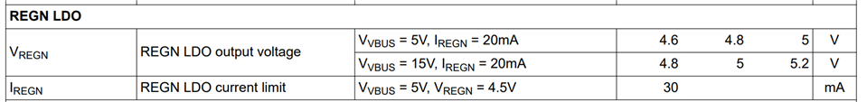

  • I'll have one doubt regarding the REGN LDO. In datasheet it is mentioned as Vregn=5V. But in our board we are getting around the 5.45 volt

  • Anasur,
    REGN output voltage spec is shown below:
    Your IC is out of spec.  Do all IC's show that?
    Regarding ILIM_HIZ, it limits the input current which indirectly limits charge current if the system load + battery charger current requires more power than the input voltage and limited input current can provide.
