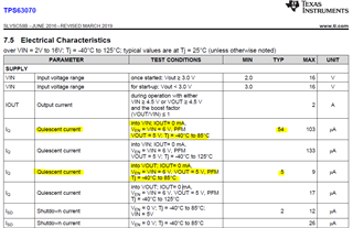

Hello, The datasheet of TPS63070 specifies two values of Quiescent current for same condition. I believe one of it is for PFM & other for PWM. Kindly can you confirm
These two quiescent current are both based on PFM mode, actually, quiescent based on FPWM mode is meaningless because device always switching in fixed frequency in FPWM mode and the current mearsured will be very high.
The difference betwwen these two values is just measured with different Pins, one is at input and another is at output.
