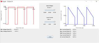

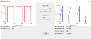

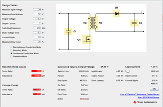

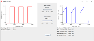

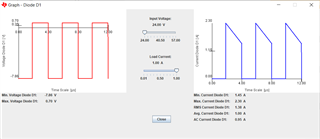

I've converted my TPS23753AEVM-001 to a 3.3V output.  That works fine.  7W may be overkill for my design.  Can this EVM be further converted to a 3W option?  I see that Coilcraft offers a POE30P-33L that is in the same family of transformers.  What other parts changes would be needed if this conversion is possible?
Thanks. PG
