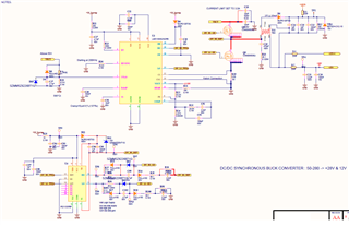

My application needs high voltage input, like 50-300Vc and output 28Vdc, 4A. I selected LM5116 because of its synchronous rectifier and high efficiency. Since its max input is 100Vdc, I added external gate driver in my application. SW is connected to GND for that reason. I have attached the schematic. There is other battery(25V) connected to the output in my system. So I need LM5116 starting normally with pre-biased voltage and not consume the battery.
Questions are
1. Is Diode Emulation still supported if DEMB connected to ground through a 10K resistor like schematic, like in start up and light load?
2. Does adaptive deadtime feature still work since SW is grounded?
If those above two stop working, does my circuit work as expected except the efficiency? If so, how much efficiency I lost?
The third question, can I use GaN Mosfet to replace SIC Mosfet in circuit? If so how to calculate the switch loss of GaN Mosfet?  The switch loss in my application is very high per page 27 of datasheet.
Please ignore +18V_Start, it should be 15V.
