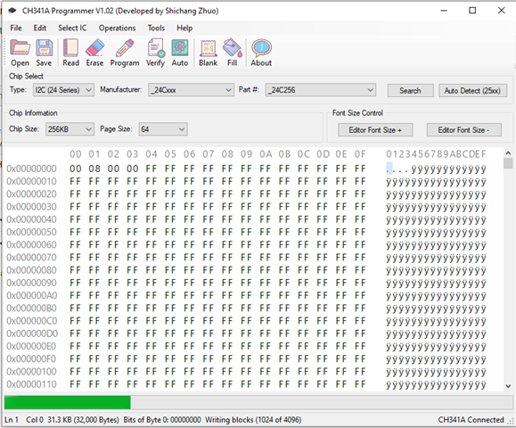

I am trying to flash my PD controller using the CH341A USB chip (https://www.amazon.com/dp/B07V2M5MVH?psc=1&ref=ppx_yo2ov_dt_b_product_details) with a binary file created in the TI TPS25750 application customization tool and it is not working properly, indicating that the value of the data is smaller than the chip size. I have attached a picture of my configuration as well as the error messages when trying to run this program. Is the physical hookup correct? Do I have the correct software configuration (eeprom), and .bin file?

    The issue you are seeing seems to be from the CH341A USB to I2C converter chip you are using. We typically use an Aardvark I2C/SPI Host Adaptor to flash the EVM on the same header you used. This flashes to the I2C EEPROM directly. I do not know the CH341A part so I cannot support that. Where did you see the recommendation to use the CH341A part?

  • Hi Anthony,
    To add-on to my previous response, please make sure your I2C connections are correct based on this PDF here. The I2C connections are I2C_SCL, I2C_SDA and GND (not I2C1_SCL ...). This looks ok to me but please double check.
