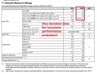

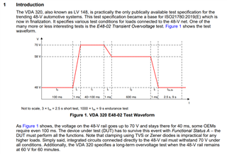

hello,
As 48V battery becomes more and more popular in automotive, LV148:E48-2 test is required which means device should function well with 70V DC for at least 100ms, while most of our smart diode and e-fuse products are 65Vmax working and 70V abs, may you share the 70V abs transient duration data?
If it doesn't support 40 or 100ms, is there any other suggestions as an alternative of LM74910?
https://www.ti.com/lit/an/snva900/snva900.pdf?ts=1696667987475&ref_url=https%253A%252F%252Fwww.google.com%252F
