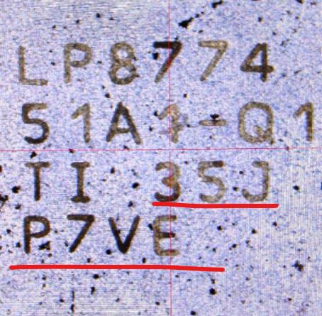

Would you please support to tell what are those letter means?
Does it include OTP version? Thanks.

Hello Yao,
The highlighted numbers refers to some nomenclature related to backend functional team for internal use.
OTP ID is indicated in device part number; LP877451A1-Q1. So, for this device OTP ID is A1. However, OTP revision can be accessed via TI_NVM_REV register bit through SPI .
I hope this helps.
