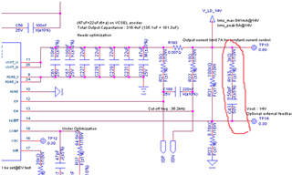

Hi all :)
I want to do a WCA on TPS55288-Q1.
I have the following questions
1. I was wondering if there is a TPS55288-Q1 WCA model? There is a WCA model for another IC (TPS7H4001-SP), but not for TPS55288.
2. if there is no model, how can I do a WCA analysis? Here is what I want to analyze

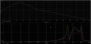

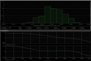

- Monte Carlo histogram analysis of internal parameters (amplifier transconductance/ power stage transconductance/reference voltage, etc.)
- Check output variation over temperature sweeping and analyze gain/phase margin
- Analyze gain/phase margin due to temperature change of passive elements applied to the setup
What does the x-axis frequency mean in the graph of the monte-calro analysis results?

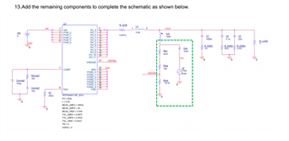

3. Currently, we have applied feed-forward cap. and res. to the feedback resistor according to TI TEST Bench guide, will this work in simulation?
Thank you for your advice as always.
